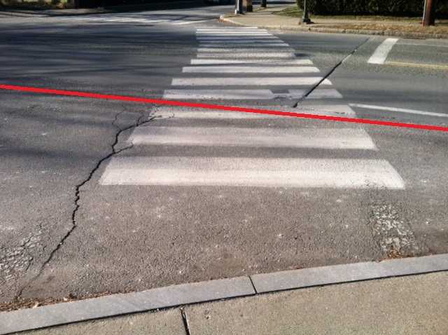

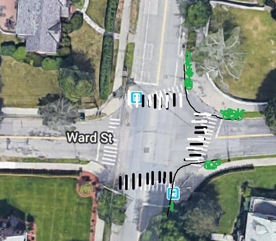

@peller Yes and this is something I spoke to Jason about several years back. I was told both the NE and the SE corners could be squared off but needed to wait until after the water main work. So if they’re paving it now in 2022… Why not do this now? Attached is a diagram I sent him. See also the photo of the distance between the curb and the actual line of travel. People routinely stand in the street waiting for the light to turn.
Also, correct, there are no ADA curbs despite this heavily used area. Five synagogues within two blocks in each direction, plus BC law school one block away, plus Perkins School for the Blind a short distance down Centre St.
CENTRE and WARD_squared off (2)
and (taken from the NE corner looking west:
follow the lines of cement_Centre
