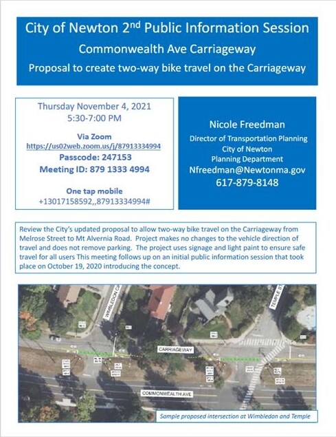

City of Newton 2nd Public Information Session
Commonwealth Ave Carriageway
Proposal to create two-way bike travel on the Carriageway
Thursday November 4, 2021
5:30-7:00 PM
Nicole Freedman
Director of Transportation Planning
City of Newton
Planning Department
Public Meeting Notice, 2 way Carriageway 2021.11.04.pdf (649.4 KB)
Second Public Meeting
5:30-7:00 PM
Via Zoom, https://us02web.zoom.us/j/87913334994
Passcode: 247153
Meeting ID: 879 1333 4994
One tap mobile
+13017158592,87913334994#
See Commonwealth Avenue Carriageway - 2 Way Bike Travel for design plan and more information.
