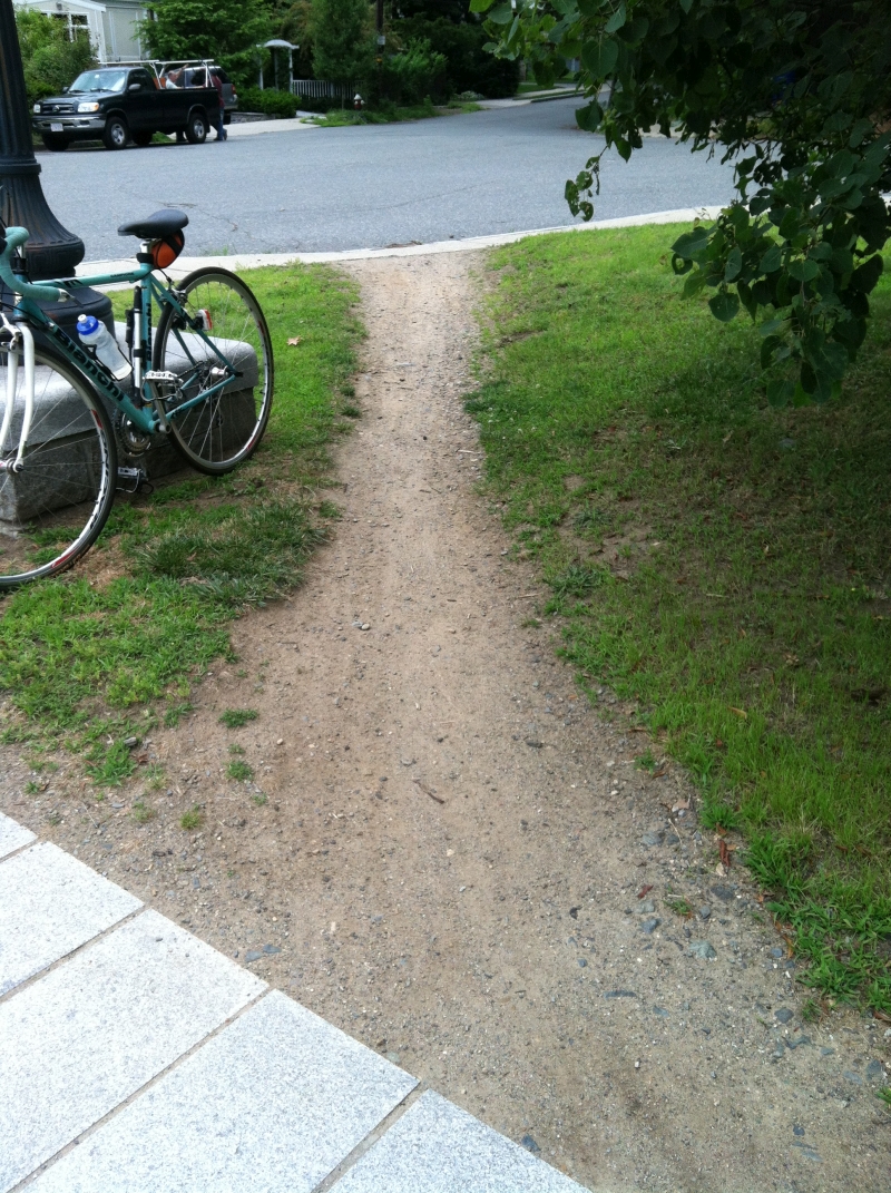

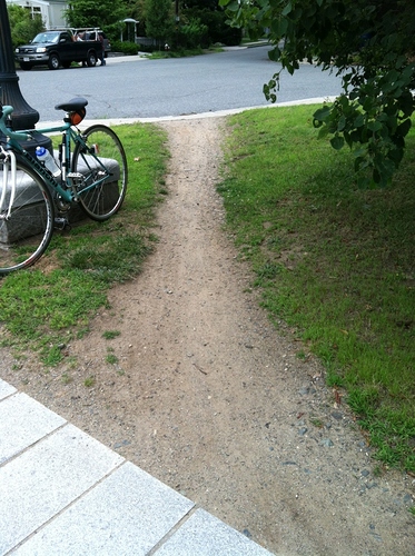

Here is a closeup of the little dirt path that bicyclists have created to connect the footpath on the east with that curb cut. So that dirt path could be easily widened, the bush to its east trimmed back, and striping- which is in this phase 1 plan - could easily be added to connect that curb cut across Beaumont to the other side:
Finally, on Beaumont, this is the intersection where the Police Dept back in 2018 rejected our request for a stop sign at Beaumont before the CR, arguing that a driver who had to stop at Lakeview would not want to stop again before the CR and then again at Comm Ave. Maybe it’s time to revisit and re-docket that request.
But no biker is going to get off the road and follow the pedestrian crosswalk, that I can tell you.

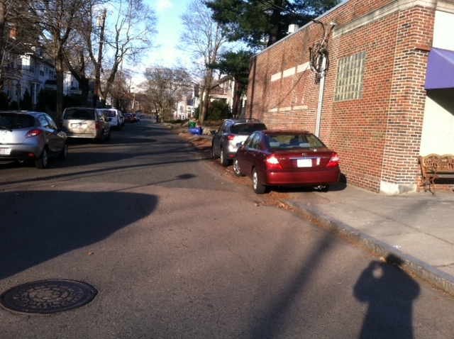

THREE Pp. 10 and 11: Commercial Zone east of Irving St
a) This commercial zone is tricky and the suggestion to make the bike lane along the berm is really interesting and creative. One problem this solves is that technically/legally the berm is NO PARKING, even though cars park there to shop. So this would be my preference and kudos to whoever dreamed that up. I also think this would be consistent with Councilor Bowman’s suggestion for the bridge over the Mass Pike east of Rowe to add a bike lane along the “berm” (EB side there and create angled parking along the WB side.
That said, I have a question: Would there still be two lanes of parking, and would each be now parallel, not angled? I think the only way to make room would be to have parallel parking. Would there be sufficient space now in between the two rows of parking?
If not, then I think that maybe this could be done in several stages: Stage 1, the current one which involves signs and striping, would have sharrows EB and WB. Stage 2 would, to my thinking, --narrow the two street openings in the berm to allow additional parking spaces; --modify/narrow the geometry of the sidewalk at Irving to allow additional parking; --emphasize parking on the south side of Commonwealth and add a pedestrian crossing across Comm Ave that begins at 521 Comm Ave and ends up at the eastern berm opening (no known street name). So if you then have the needed number of parking spaces, you can just create the dedicated bike lane along the berm, and still allow customers to safely park, exit and enter their vehicles.
b) My other idea on this section is to add “LOADING ZONE” parking (at minimum this would requite a sign only. Long run, later phase when there is funding available, modify the curb to enhance this purpose) along the east side of Irving Street. Perhaps this would be suggested at Traffic Council. We see the vehicles from these commercial establishments often parking along the berm or along that angled parking (see two loading vans from the commercial establishments in the photo provided) and this takes away from customer spots. They are also often bigger vehicles and make it more difficult for drivers and bicyclists to see around. So add LOADING ZONE parking along Irving, get those vehicles off of this section, and then that would make it safer for the bicyclists Irving_parking.3 and the cars of customers backing out. blackers.parking_summer2020_commercial.vehicles. Because the curbs on Irving would have to be redone, this might not be an immediate option.
c) A later phase solution would narrow the berm openings, which are currently excessively wide, thereby adding more parking spaces, and improving parking along Irving Street, then possibly adding more parking spaces on those locations, and then eliminating the parking by the (new) BIKE PATH.

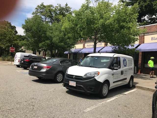

On Irving Street, the commercial parking is actually right ON the sidewalk. This is primarily a pedestrian and accessibiliy concern and should be addressed immediately. Constructing a proper curb would help. There is also a US Mail box in the way which should be relocated.
If there continues to be parking along the side of the building, either vehicles or as a loading zone, is there enough space to pass, or should there be additional parking restrictions?
Interesting, Adam. There are no signs on Irving that say “Loading Zone” or any signs at all there. If it’s so designated currently, I see no good reasons why signs could not be posted now, unless the City determines that they don’t want to have the expense of installing them, then moving them to a different location and reinstalling when the larger area is redesigned. So this can be looked into.
Meanwhile given the area is designated commercial zone, those signs could be posted now.

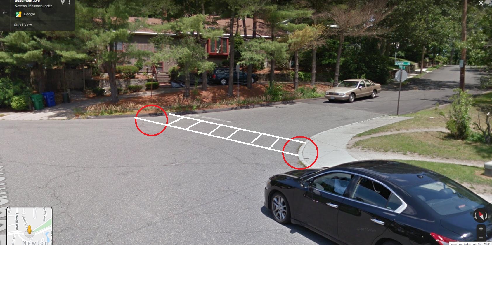

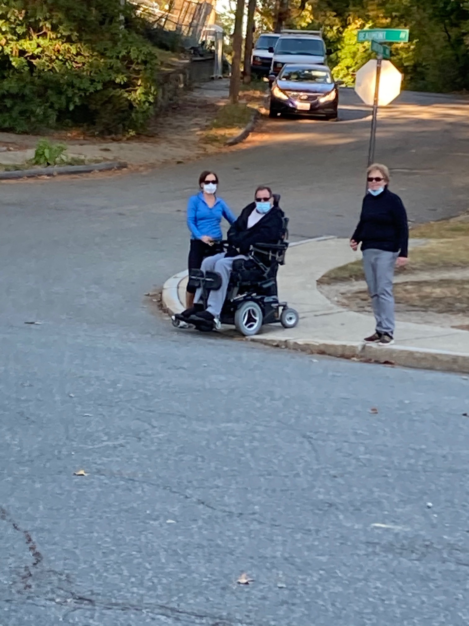

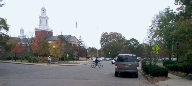

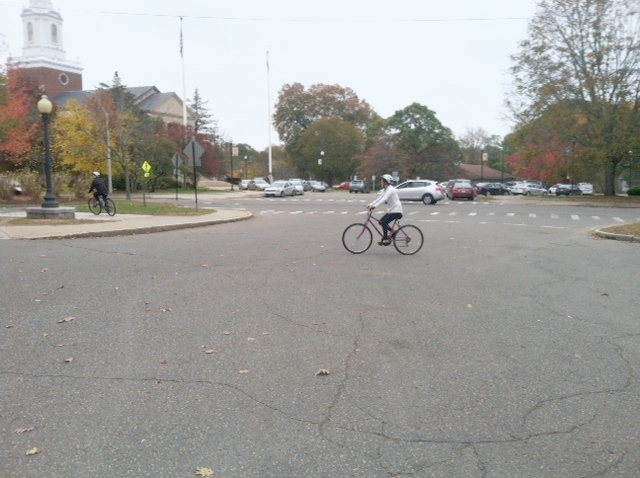

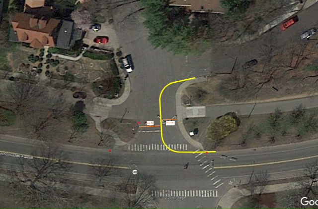

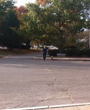

A few photos about the proposal for Beaumont to illustrate my points;

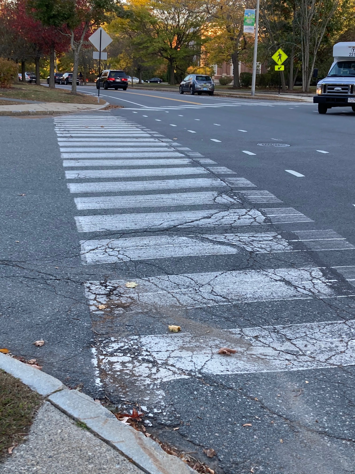

  1. Why no EB or WB cyclist will use the existing crosswalks to get across Beaumont: Shown, heading EB:
    first:
    which leads to this crosswalk and puts the cyclists into dangerous proximity to fast traffic on Comm Ave, which includes motor vehicles turning into Beaumont:
    Finally:
    onto the sidewalk at the east side of Beaumont, and then turning sharply onto this other sidewalk that goes past the bushes
    then turn again onto the walkway (approximately where that pedestrian is) and continue east.

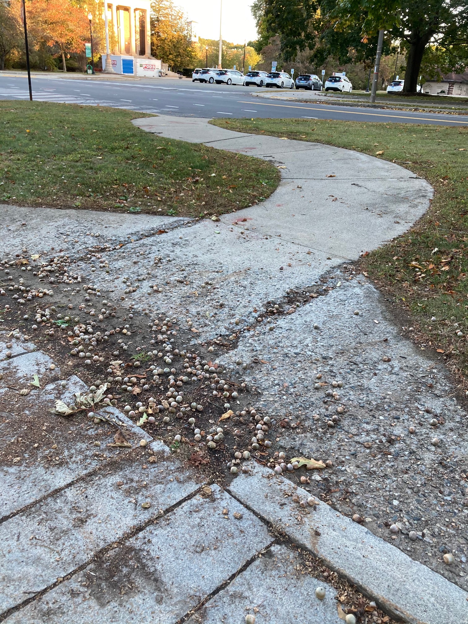

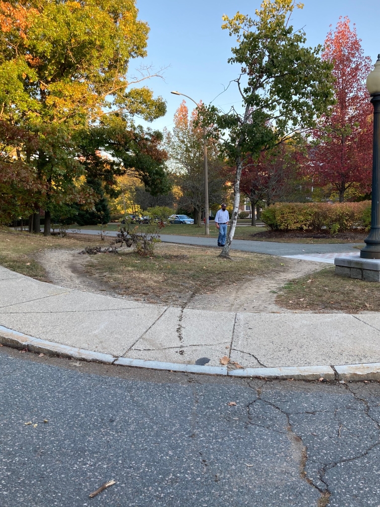

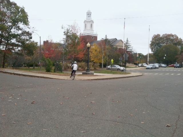

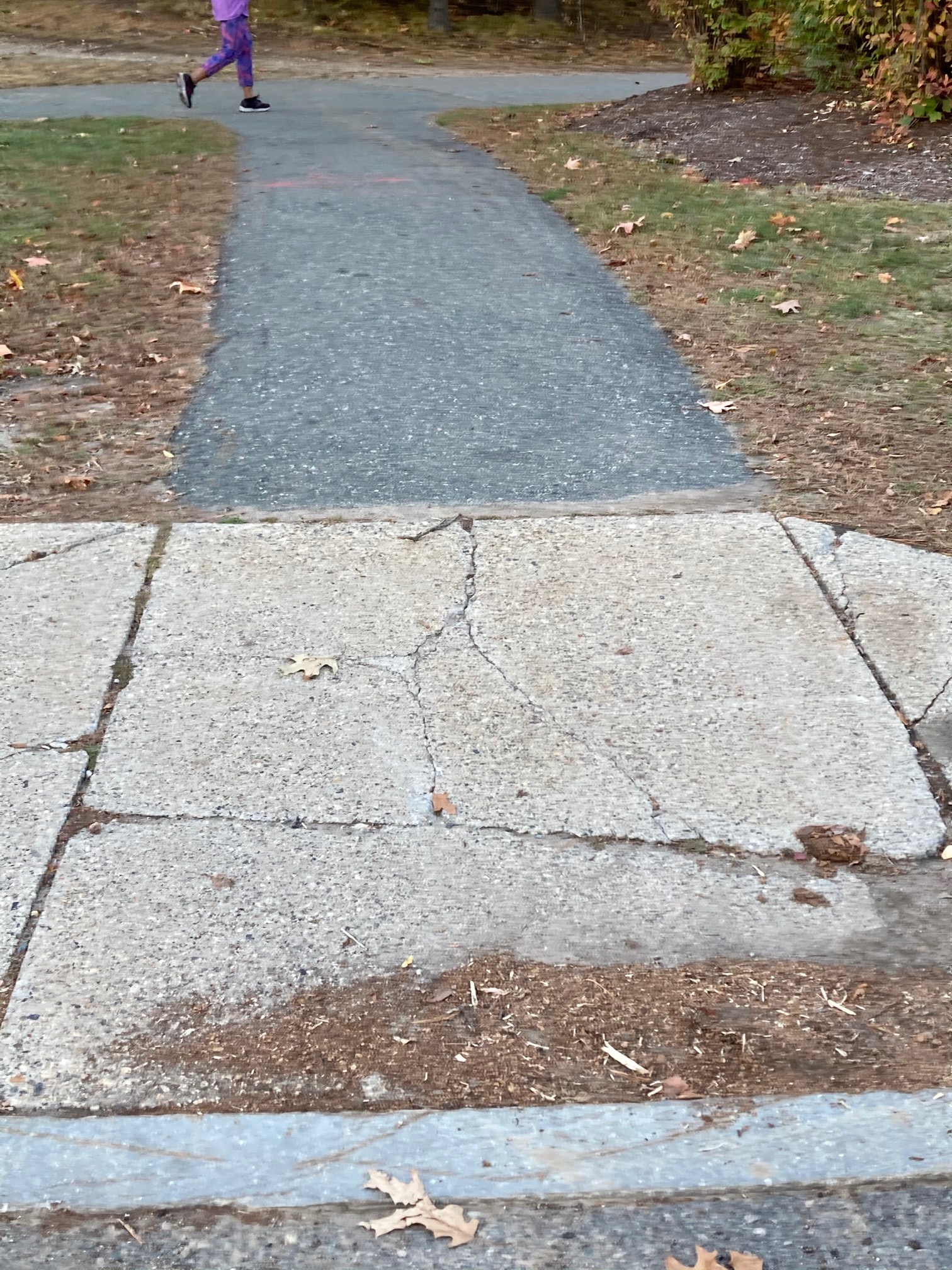

Next, the existence of a curb cut which many bicyclists currently use, including disabled (photo taken today). This group then crossed Beaumont and continued along the CR.
A closer look at that existing curb-cut: Cyclists have created a path along each side of the bush. This curb-cut is actually at the corner of Lakeview and Beaumont.
A bike lane could be striped to cross Beaumont.
Designated how, currently? I’ve never Irving used as a loading zone. The problem I see is that cars are routinely parking on the sidewalk around the corner on Irving. That is simply illegal and should be enforced. This isn’t a bike wishlist, it’s a ped and ADA requirement. No signage necessary, but a new curb, on Irving not Commonwealth, better delineating the sidewalk area would be helpful. If there’s a need for more parking for the businesses, they’ll need to park safely next to the sidewalk on Irving or somewhere else. If that’s not possible, traffic council should look for a better solution, in consultation with the businesses.

Regarding CR/Lakeview/Beaumont, the problem is that there is no curb cut on the eastern side of the (closed) carriage road. Apparently, the reason this entrance was designed this way was the city vehicles were using it for parking.
I think the best thing to do is for DPW to put a small amount of asphalt at the curb of the carriage lane to make a ramp, and consider putting some sort of barrier in the middle of the carriage road (a planter or a flexible bollard) to discourage vehicles.
I’m actually surprised that such a straightforward change isn’t already part of this plan, or even adding a real curb cut.
Draft Design Plan presented at Oct 19 Public Information Session
Mike,
You are correct in noting the existing curb. Actually, Jason and I spent a bit of time there and did discuss this - this was in fact my original complaint - and in fact there is a drawing that Jason did on just that concept. The reason why it wasn’t proposed at this point in time - I am guessing - is that this Phase 1 is just stuff that can be done with signs and striping so they don’t have to go outside the dept to fund the change. Adding curbing would involve different funding.
Jason did in fact try at one point to get DPW to modiify the curb there when they were doing curbing across the street where the War Memorial is. In addition to adding the curb, the plan was to stripe a few feet out from the curb to keep drivers from Comm Ave WB turning into Beaumont from running into runners and bikers stepping off that curb. You can see the potential for an unfortunate collision.
I’ve added the drawing Jason did here. Jason Sobel comm-beaumont
In addition, we also discussed and he was open to a curb at the corner of Lakeview and Beaumont, where the currently is not one. This drawing with the pedestrian crosswalk is mine:.
Finally, Jason was open to adding a curb on the NW corner of Beaumont and the CR where the red circle is. There is currently no curb there and there are many individuals who do not want to walk in the Carriage Road at that point, especially right before Walnut. This would be for pedestrians and it would be where the woman and the dog are; you can see the two stepping over the curb here.
Beaumont_walker_Mailbox.circled
So I think that after this Phase 1 gets approved, being optimistic here, this would be one of the next projects in that it is one of the least costly and curbs are being put in regularly.
I hope that responds to your thought.
Jane

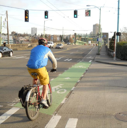

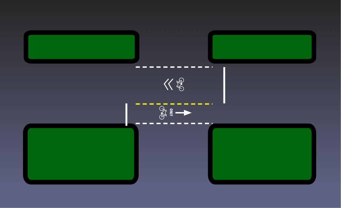

Currently, the plan has green bars on the “contraflow” (eastbound) direction of bike traffic at the different crossings. That might cause confusion for “normal flow” bicyclists (westbound), who might think they need to be in that green painted lane.
What about the idea of, at street crossings, painting the edges of the carriage road travel lanes in with white or green ticks? That would make it clear it’s a through way, but also delineate the entire potential conflict zone. Putting bike symbols in the intersections (bike with arrow facing east, sharrow facing west) might also increase visibility and awareness for drivers.
Something like this. It has more paint on the street, but it’s concentrated at the street crossings rather than in front of people’s houses.

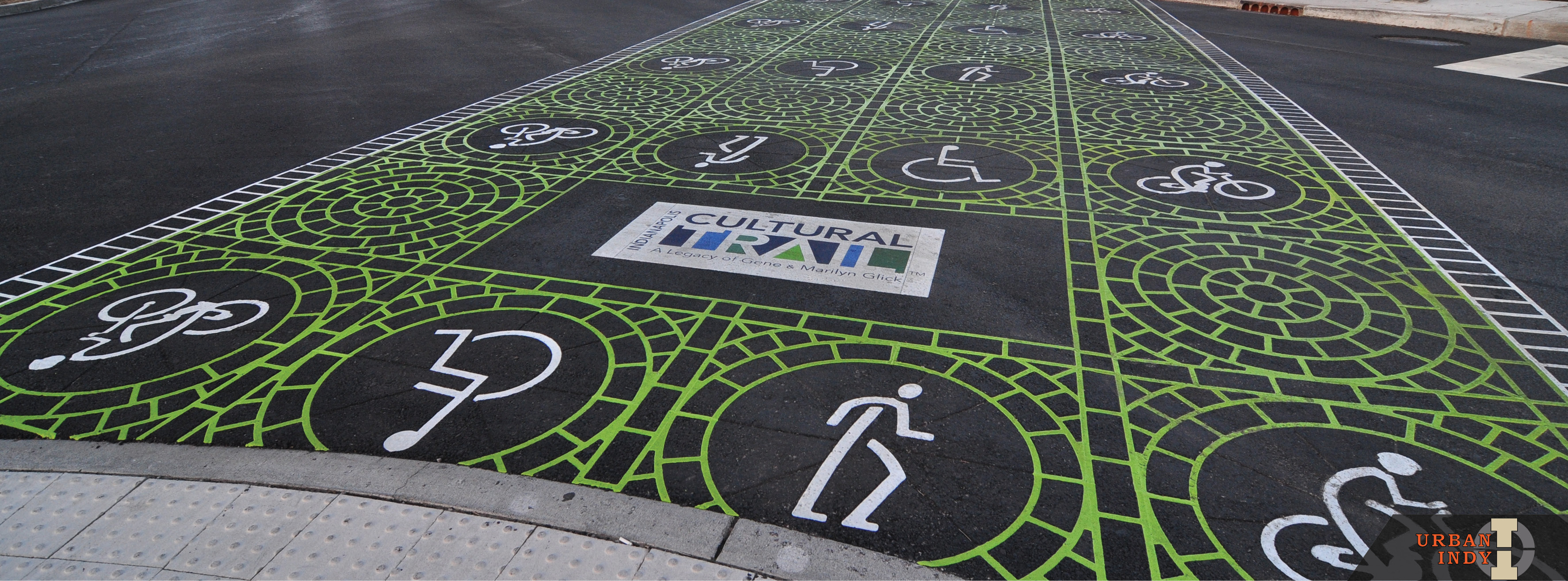

It isn’t directly comparable, but the lovely Indianapolis Cultural Trail has these types of street crossings:

That ICT is very jazzy! Sorry it took so long to respond.

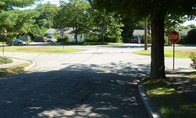

To this point: Many of the N/S crossroads are straight and level, but many, particularly Chestnut to Auburn, the drive down to the CR and Comm Ave is a descent that is also winding, with tree foliage obscuring signage. If the roads derived from trails, or carriage trails, so that the roads didn’t go straight downhill at an unsafe speed, they took a path that veered slightly east that lessened the angle. But this means that visibility of who is coming east from the west is lost. And often the stop sign is hard to see, behind a tree. Think Wauwinnet, Prince…
wauwinnet

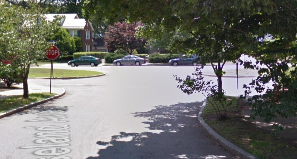

Prince: A highly irregular (and unsafe) geometry plus a berm opening – that is so wide that contractor trucks can park on both sides of the opening and still cars can come in and out-- that creates all sorts of confusion for all. A green striped line across the opening would be great here. Multiple times I’ve seen WB kids on their bikes just stop and ponder where they’re supposed to go! I think here at Prince these lines would definitely be used to guide EB and WB cyclists into safe lanes.
Think Valentine, where drivers heading south are doing downhill and winding right, cannot see ‘around the bend’ and cannot even see the STOP sign ahead sign before the CR or the really totally located “bicycles and pedestrians ahead” sign. (We even had the word “STOP” painted, and still most drivers do not stop until before Comm Ave. (Valentine is where we met last month with Chief Carmichael, Sgt Boudreau and . Lt. LeMains. Even while the police were standing there, in uniform, drivers went right through the CR stop sign. I think this green line is very clever and essential.
Morseland has heavy NB and SB vehicular traffic for many reasons, and it’s not on a downhill, but the road and berm geometry, in combination with overhead foliage, is such as drivers heading to Comm Ave cannot see the CR stop sign or anybody coming from Cedar west. Foot traffic (pedestrians and runners) also abound here. The green stripes will really be a visual eye-stopper.
At Exeter, Temple and Dartmouth, where the berm openings are too wide and the painted crosswalks across Comm exceed sanity, the green stripes would add some order.
My 3rd and last point: These striped green stripes would not be in front of people’s homes. The lines are only in the intersections, and the homes at the NE and NW corners of the CR are significantly distanced - not to mention heavily landscaped - from the intersection itself.
Thanks Jane. I guess my thinking is that the green bars don’t by themselves do that. They don’t say, “look to your right”. They are just there. That’s why I suggested doing a better job of demarcating the entire carriageway right of way and providing directional indicators for bicyclists that will at the same time inform drivers.
Your examples where drivers don’t stop suggest that we should better highlight the entire carriageway right of way at intersections. Drivers might not be expecting bicyclists to the west, but they probably aren’t yielding to bicyclists on the east either.
I think of the lines as providing a general sense of order, the order being: WB, which is against the direction of motor vehicles, should stay as close to the berm as possible, whenever possible .
I agree that will happen on the majority of the carriageway. It’s at the intersections (which are a limited amount of the carriageway, but potentially high conflict) where sorting people out makes the most sense. That’s because motor vehicles may be entering the carriageway, we want them on the right side of the roadway WB and everyone else right side EB so that we don’t have a head-on crash. The EP plan does that with short bits of striping just outside the intersections. I suggest extending it through the intersections.
I understand that. thanks for the clarification. I was just saying that in this alternative idea, there might be more traffic-y paint in the actual intersections, but that’s likely not going to get people more upset.

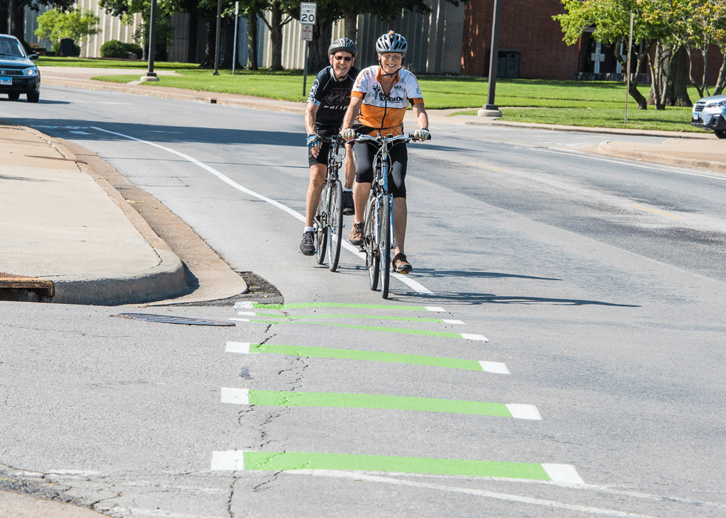

I found these two images online…
Above, the stripes are a light green and not so fat. What was your impression from seeing it in a fuller screen?
Then this thicker sold green (which I kind of like):
